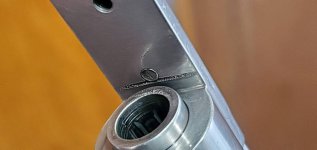

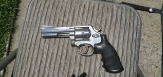

Recently I began developing a max velocity 125 gr load for my 23 year old model 686-4 357 magnum revolver and sure enough the dreaded top strap flame cutting started to develop with some forcing cone erosion as well. I've read varying opinions ranging from not to worry about the flame cutting because it stops eventually before rendering the revolver dangerous, to stop using the revolver immediately if you value your life. From what I can tell, the depth of the cut is only about 1/16" at the deepest part so I'm confident the firearm is still safe to use, but I was hoping to do something to prevent the flame cutting from getting worse. How would a gunsmith address this issue?
I saw online that someone placed a piece of spring steel above the forcing cone on a S&W revolver, but there were no details on the type of spring steel or where to get a piece that fits neatly without much fitting. My initial thought was to apply some stainless steel tape in that area, but I'm pretty sure that would only be a temporary solution with me having to replace the tape frequently. Would something like JB Weld be useful in filling in the groove and preventing further cutting? I'm hoping to get recommendations from the experts on the forum for something that I can do at home with my limited machining skills and tools.
Below is a picture of the revolver and a closeup picture of the top strap and forcing cone.

That's pretty severe flame cutting. It's not the depth of the cut I would worry about, but the stress riser that it creates. If this happened after a low round count, it's time to stop using this load and find another way. I'm sure the piece is safe, but it's time to change course. One of the pictures in the search link showed a neat piece of carefully cut sheet metal formed into the hot zone. This could work great as a sacrificial shield, but I would be wary of it flying off in bad directions if not carefully secured by careful bending. The sight screw hold might offer a securing point. It's interesting to note that the front sight screw has not been ablated like the surrounding frame material.
I don't think your gun is dangerous but will become that way if you keep it up. Forget the JB weld, it's plastic glue, not a fire shield. Then stop using those flamethrower loads, 158 grain semi jacketed semi wadcutters have been used on everything from grizzly's on down. Anything bigger than that needs a cannon.

first of all that is far from being .062 deep. get out your calipers and dial up .062 on it and compare.
after a certain point the flame cutting will stop because the depth will be deeper that the focus point of the gas coming through the cylinder gap.

One thing I notice is that OP's revolver bbl only has flame cutting to the edge & face of the bbl itself at the 12 oclock position,,and that seems to have cut into the top strap right above it.
No other portion of the circumference of the barrel face is effected by any of the same type of damage.
Unlike Post #10, Lou the Welder's 357 where the entire bbl face shows the same type damage s I would expect it to.
I realize that Lou's may have a much higher round count and thus more damage to it.
But I'd still expect the OP's gun to show what damage we do see at the 12oclock position not only there,,but evenly all around the breech face of the bbl.
Could the bbl face be 'off' square with an extra wide gap at the top,,or even the face of the cylinder not be square with the bbl face?
That these revolvers do 'gas cut' is not a question. I only wonder why this one shows the issue at the 12oclock position only.
I agree that the depth of the cutting so far is very much less than the estimate given. The revolver is still safe for use IMO.
