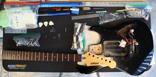

A pic of the non-functional Strat here. I think the volume pot is shot as I get nothing from any of the 3 pickups. Plus, when I disconnected them from the old wiring I measured them all with my multimeter and they all show continuity. So looks like all new wiring is in the cards for this one.

A lot of it cleaned off with some alcohol. I am mainly a proponent of leaving the finish as is. I will add some thin super glue to the spot where the finish chipped off down to the wood so it will keep it from expanding and provide some cover for the bare wood. It boggled my mind that there was 4 different kinds of screws holding the pickguard down. Almost half of them small bolts instead of screws. I get the feeling I will be drilling out and plugging a LOT of screw holes on this one. Probably replace pretty much all the smaller screws. There was even a off size screw on one of the pickups.
