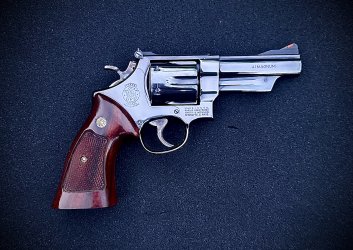

I used Flitz in almost the exact way you did on my Model 27-9 after the frame and sideplate had developed a bit of a haze. The one, light application worked great and the haze has never returned in the several years since doing so.
Yes. That's what I did. I used barely a hint of it and didn't use it like you would use a polishing compound. It was the faintest wipe on and just a real easy wipe off. It worked like a charm, but it certainly nothing. I'll be doing on a regular basis. Only something I would do if nothing else works to remove a stain like residue that won't come off with CLP.
That looks great.
I think that's all it needs is just the barest amount.
