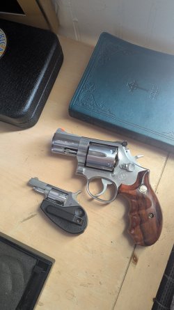

The only Smith I own is a 1989 686-3 not sure if that counts as new, old, or in between but it's pre-Mim flash chromed hammer/trigger with a hammer nose rather than frame mounted firing pin, which is something I really wanted. Whether that makes a huge difference or not, who knows...

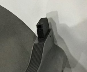

My brand new 610 mountain gun lost gold dot insert after about 25 rounds. Have around 30 assorted S&Ws from a 1905 to a 686 and 617. Then theres the other stainless ones. Never had any issues with any J,K or N frame blued S&W or stainless ones.

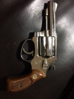

I’m going to claim ignorance and hope there’s no backlash for my stupidity. I’ve been collecting Smiths since I was old enough to buy one. I own everything from a No.1 tip up to a U.S. Army Schofield to a ported 8.5” 629, and darn near everything in between.
Please, somebody, tell me what is so wrong with “post lock guns”?
The thing about new Smiths are some of the offerings simply were not available pre lock. Like the S&W 60-15 Pro Series. Three inch BBL with vastly superior sights, night sights at that. The ability to handle .357 Magnum. (ouch, but if modern alloys make it possible, why not?) To me, it is a .38 Special, but it will handle all the Plus P .38 Specials my hand can take. Round butt for concealment, but it comes with larger grips if that is your preference. Heck, I had to have one if only to replace my beloved Nickel Plated 36 three inch! I have not carried the 36 since I finished the shakedown shoot with the 60-15. And if it gets scuffed up a bit, it does not hurt my heart quite so much. But in 50 years I am sure a future collector will curse me for actually carrying/using a 60-15, just like we do today about a guy that had the gall back in the day to use his .44 Triple Lock!!!!Anniversary.JPG
