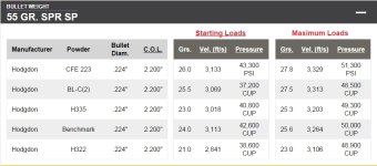

I load on a LNL-AP and am guessing I want to remove the de-capping pin from the full length sizing die and load as normal. If it matters to you I'm using 55gr Hornady PSP bullets. I'll probably work up some loads for each of the powders in the attached photo. YUP, gonna rain ALL weekend in the DFW area :)
Anyone have any insight using this or other already primed cases on a LNL-AP?
