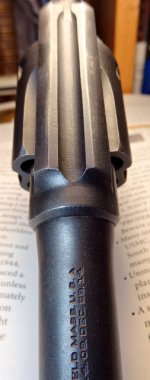

S&W .38 Special CTG Victory Model Serial No. V67232. Number matching on inside right stock, under barrel, and on cylinder.
Right side of barrel 38 S&W Special CTG
Finish: Black brushed
Patent dates on top of barrel
On right side of grip frame at the butt: "T", "J", "A", "6", A dot, and a larger "S".
On the left side of the grip frame at the butt: "P", and "P"
Smooth backstrap. Grooved trigger.
On the yoke: 11562 and "S" with 11562 and "P" on the frame next to the yoke.
The revolver is tight and shows minor holster wear marks. The bore seems perfect and it has every sign of being carried more far more than being used.
No markings of backstrap or sideplate (beyond S&W Trademark), and no markins on left side.
Ordnance bonb mark on butt across from serial number..
