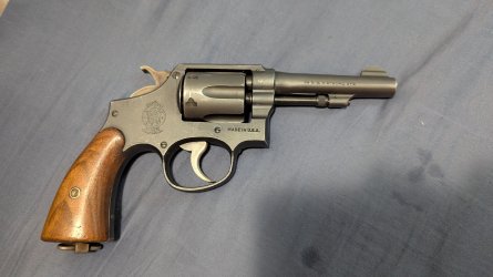

Hey all, I have a DSC Victory model, somewhat early but looks like it has the late finish.
No proof marks except the flaming bomb on the butt by the serial number:
V58439
If possible I'm curious when/ where it was shipped and if the year of manufacture can me confirmed?

No proof marks except the flaming bomb on the butt by the serial number: V58439
Also, ordnanceguy, you have an original DSC box, could you give me the dimensions? Also, do you know what else would have been in the box? Wrapping paper, cleaning rod, sheet of paper, etc. I'd like to do my best to recreate my own
Hello Blasfimus:
Welcome to the Forum. That is a nice looking Victory.
Your revolver likely shipped from the S&W factory in the August-September, 1942 time frame.
With guns shipped under DSC authorization without any property markings it is very difficult to opine as to a likely shipping destination. Most DSC guns shipped in handful quantities, not large numbers, so extrapolating a shipping destination from nearby serials with known shipping destinations is pretty much of a fool's errand. You will need to secure a S&WHF letter to find out what the destination was. If you do that I hope that you will post back here with the results.
Yes, I do have a DSC Victory box in my collection. The dimensions are 11" x 1 3/4" x 4 3/4". The DSC box contents were the revolver, kraft wrapping paper (not VCI paper), and a twist wire .38 Special bristle brush contained in a wrapper/envelope. Also included was a one page Instruction sheet. The DSC guns did not ship with a cleaning rod. The image below shows most of what is found in a DSC box. (The image and the box shown are not mine but since I had the photo handy I have included it here.)

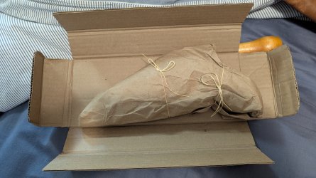

Thanks a bunch for the info.
I've got the box cut out now, I'm having trouble locating kraft paper that's a lighter color than my cardboard, when I find one Ill share it here.
Do you know how the revolver was wrapped in the box? I tried wrapping it like a flag and tying with thread. Looks legitimate enough but still moves back and forth. Let me know your thoughts please.

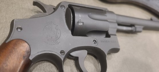

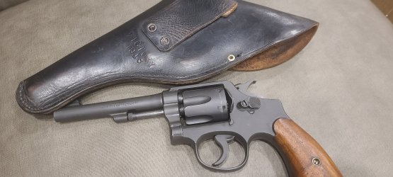

Just got a Victory in great condition for $420 from auction, wondering if it is has been refinished and any other information available. Also curious if the included holster is original.
V297331 all matching
Crane arm marked 25896
US PROPERTY G.H.D.

...wondering if it is has been refinished and any other information available. Also curious if the included holster is original.
Hello Yessir:
Your revolver likely shipped in the April-June, 1943 time frame. It was a Lend Lease contract gun.
The hammer and the trigger have been refinished from the original case color hardening. That suggests to me that the entire piece has been refinished.
The holster is not USGI. It appears to be a commercial item.

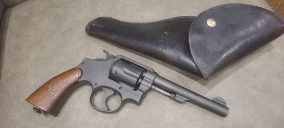

That's the worst news a man can get, but I appreciate the info! I had a feeling the finish looked off, but I've never seen other examples in person.
Interesting that the holster is dated the same year the gun shipped. I wonder if a previous owner already found out the ship date and marked it, or if it is just a coincidence.
More than likely, the holster markings are a former owner's attempt to make it look military to deceive and raise value from potential buyers. Lots of folks out there put fake markings on stuff for that purpose. Most WWII-era Victory flapped holsters are unmarked; some by Boyt will be marked and dated.

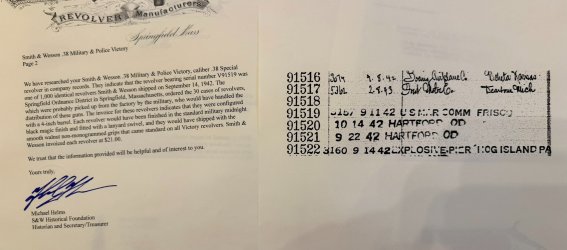

The first one is one I recently acquired with a ship date of September 14, 1942 to fulfill a Springfield order. The log for this Victory shows a 9/11/42 date with USMAR COM FRISCO. I assume this means the revolver was dispositioned (maybe shipped) on Sept 11, 1942 and that its destination was the United States Maritime Service Commission in San Francisco, CA. Per the rack number on the butt I assume it was later issued to a police department or some other agency.
Looking for feedback on the above information and the best way to communicate what is in the letter. Thank you in advance! Lyle

Your S&WHF is a little bit confusing in that it implies a direct military connection which I don't think was the case. The Springfield Ordnance District ordered the revolvers and would have been billed for them. Your revolver bears the Ordnance bomb (the "shell and flame") mark on the butt which indicates that it was inspected and accepted for the government under Army supervision. This practice is also consistent with guns shipped under DSC authorization.
From the Shipping Ledger page supplied it shows that your V91519 shipped from the factory on September 11, 1942 to the U.S. Maritime Commission in San Francisco, CA. As you may know the Maritime Commission in WW2 was a civilian agency responsible for building huge numbers of civilian operated ships for the war effort. These were principally the Liberty and Victory cargo ships and tankers. The San Francisco Bay area was a hotbed of military and civilian ship building during the war with the Kaiser organization operating four shipyards in the Richmond, CA area. All of these civilian ships had to be outfitted and that included a complement of small arms.
The 48 marking on the bottom of the stock does indeed appear to be a sort of rack marking. It seems doubtful that any civilian Maritime Commission ship would have had 48 revolvers aboard so, as you suggest, it may be that this number was added after its service with the Maritime Commission. Charlie Pate noted that after the war ended many Victories that had originally shipped to civilian destinations were returned to government control and handled by the Army. That may be the source of the 48 marking on your revolver, but hard evidence to support that is lacking.

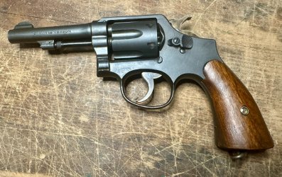

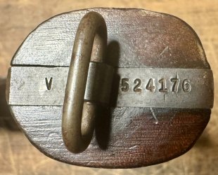

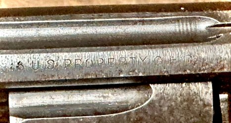

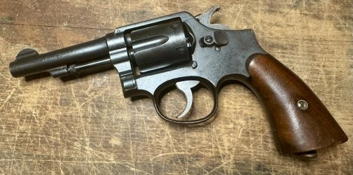

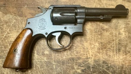

Next up is V524176, 4" in 38 Special, Shipped February 9, 1944 to U.S. Navy Norfolk, VA. It has the U.S. Property G.H.D. stamp on top (it is quite faint so had trouble taking the picture).
What is the most likely disposition of this revolver? Thank you in advance! Lyle
