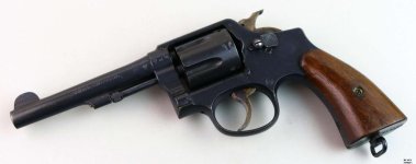

Trying this again. I got this Victory at a local show in July 2023.
S/N is SV775003, with "US Property" and "GHD" on the top strap.
I know it's a late production, just trying for more info. Thanks.
