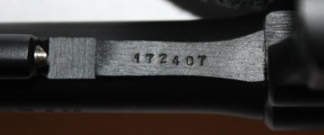

Serial V172407 6 in barrel photo
Here is the pic of my 6 in barrel gun

That star on the butt certainly looks to be the factory repair/rework mark I mentioned earlier, which means essentially all bets are off on that barrel being the original. Strongest possibility is that at some point it went back to the factory where a new barrel was installed and numbered to the gun.
Thanks alot I got it from my great uncle who was with a rail road unit in europe. I was wondering if he had aquired it there. I appreciate it.
