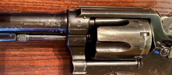

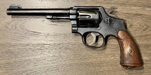

Just picked this up and I'm hoping someone could share a bit of info and history. Six inch barrel in 38S&W; bluing appears to be original. Not sure if grips are original, but they are fit to the frame perfectly. S/N 740765 - matching on frame, cylinder and barrel. "P" on the butt with serial #. Variety of British proofs (BV, BP, NP) as well as "Not English Made" stamped twice - once on barrel and once on frame. C with an up arrow proof on the frame. Crossed swords with an "E", "B" and "1" on the frame. Any thoughts? Thanks much.
Interesting gun.
It's originally from spring 1941, likely March/April, and was deliverd to Canada likely on a direct-purchase contract, but possibly through the British Purchasing Commission. That's where it got the Canadian military property stamp arrow/C. But it ended its career in Britain or at least in the hands of a British surplus dealer who had it commercially proofed at Birmingham for sale in 1954; those are the proofs on the barrel and frame, including the crossed-sceptres viewmark (E=1954).
The stocks are earlier, 1920s non-medallion M&P stocks.
