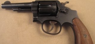

Hello! I have a seemingly early victory model with a serial number of V224xx. it is a 38 special. Everything has matching serial numbers including the smooth walnut grips. Would anyone know when this gun was produced? I am thinking about early 1942 or late 1941. It is a US Navy model. It is in excellent condition.

For some reason I cant put pictures of it on here :mad: but the revolver is in excellent condition it still retains 95% (if not more) of its finish. the bore is in excellent condition. and mechanically it is very solid. I have done some research and it seems the revolver has some rare features to it, for instance, according to the serial number... the 38 specials were not to common, and also sense its a navy marked revolver, the "P" marking and the "S" marking on those type of guns is more rare. Again everything has matching serial numbers and that includes the grips.
All Navy-marked Victories were in .38 Special. I don't know of any with the S marking, and certainly they never came from the factory originally with an S, as that did not start until early 1945, long after Navy marking ceased. It is possible that some of the early Navies may have later been factory-modified with the addition of the improved hammer safety, and an S stamping added to the sideplate to indicate the change. You may want to pop off the sideplate to see if that has been done. I'm not sure that would have any significant effect on value or not.
Nonetheless, in the condition you describe, and assuming originality, you shouldn't have much of a problem in realizing about $1000 for it.

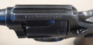

Hi! I've got one marked US property HGD. Ended up in Norway with an American sailor in the 1960s. S/N V 564270.
First - what caliber is stamped on the barrel?
V 564270 would indicate likely shipment in March or April 1944. The U. S. Property stamping would indicate it was Lend-Lease if it's the British version chambered in .38 S&W (AKA .380 Revolver Mk2), or simply that it was U.S. property if chambered in .38 S&W Special, as used by U. S. military forces. The initials should be G.H.D., not H.G.D. That inspection stamp stands for Colonel, later General, Guy H. Drewry, the commander of the U. S. Army Springfield Ordnance District.
Posting pictures might elicit a better assessment.

The caliber is .38 spl. The text on the right side of the barrel is 38 S&W SPECIAL CTG. And - you're right. It is GHD

I have recently received a 38 special victory serial # v 702436
My father was issued this as a pilot in WW2 flying fighters off the USS Suwannee. serial numbers match on the cyl. and the frame it has on the top strap US PROPERTY GHD On the barrel is 38 S&W special CTC Any info you have would be helpful

Nearby SNs have lettered as shipping in October 1944. Early Navy revolvers were stamped as U. S. Navy property, but that stopped at about SN V 267000. After that, the "U. S. Property" stamp on the topstrap was used, the same as all other military Victories. Yours is in very nice condition, and the leather is a real bonus. A great prize and a valuable family heirloom.
By the way, one of the major purposes of issuing these revolvers to Navy flight crews was for signaling, using tracer bullets.
