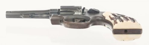

I bought a very tired but solid 1942 era Victory from a local auction. The mechanics seem good, so I am going for a period color correct re-parkerization on it. There used to be a company in Knoxville, TN that I used and they were reasonable, but they are no longer in business...That was 20 years ago.
Any recommendations, that won't break the bank too badly? Anybody on here do that?

Attached is a quick and excellent explanation of the finish on the Victory Model revolvers by our resident Victory Model revolver expert Charlie Flick. If I understand it correctly, if you are trying to match the original finish, it's not going to happen. However, if you just want it re-Parkerized, Ford's Guns in Crystal River is supposed to be tops in our neck of the woods. Maybe that's who you were thinking about? I believe it will set you back around $350, and there used to be a significant waiting period. FWIW, if it was mine, I would replace the lanyard ring and a put a set of original (used) wood military grips on it, and leave the finish like it is.
One thing you may want to consider before you do anything to it, is that it could be a USAF security police revolver. I'm going to go find and post a picture; so, that you can see what I'm talking about. If that is the case (a S&W letter would tell you), I would definitely not do a thing to it.

I don't believe it is a USAF gun, although I will letter it to be sure before I do anything...From what I have seen, (pic attached), The early USAF LeMay guns were nickeled Victories with lanyard ring attached and ring was nickeled as well. I remember reading on here that the letter wouldn't indicate a USAF SAC gun because those guns were pulled from existing DoD stocks and given to the USAF as needed. The letter would only indicate that it was sold to the US government on its original 1940's invoice, not the 1960's redo.
On this one, no "US PROPERTY" or "US NAVY" markings on topstrap or side of frame.....It is .38 Special 4 inch with two ordnance bombs on butt...It came from a Florida auction in Tallahassee.
As to the parkerizing, I know it won't be the "midnight black" finish, but I can't stand the way it looks now and a nice clean park can only help it...I am getting the correct grips and lanyard ring. The lanyard ring hole is open and the pin is still in place, so a correct ring will be a 5 minute install.

I think we have gone completely off the rails here regarding some of the replies. Except for a very small number, Victories were always hot blued over a dull bead blasted metal finish. It was called both military midnight black and black magic, NOT phosphate (Parkerized) finished. These are simply names for the hot dip black oxide bluing method still in common use by most gun manufacturers today. It was much faster than the traditional S&W bluing process so it speeded up wartime production greatly.
If you want to refinish it like it was when left the factory in 1942, simply get it re-blued without polishing the metal. It could be re-bead blasted before bluing if you wish, and that might look better. This information is widely known and has been discussed on this forum many, many times. Not sure how the story about Parkerized Victories ever got started. They weren't. Except for some rebuilds done by the Australian Military after the war.
Any local gunsmith with a bluing tank and a bead blasting booth can do the job. It is very simple, I have finished many guns that way myself. No need to send it off to Ford's or similar places and spend a ton of money.
A simpler and cheaper method is just to degrease the gun well and cold blue it with Oxypho Blue from Brownell's. It will probably look just as good. You might try that before doing anything costly. And lose the Franzite grips.
If you still want to give it an incorrect phosphate finish, which I cannot recommend, there are DIY kits available. It is a fairly straightforward and simple procedure.

The original finish was Black Magic (chemical blue) over 120 grit sand blast. With the lack of markings it was originally a DSC shipped gun for domestic use. The SAC/USAF guns will not letter going to the Air Force and they were chrome plated, not nickel.
