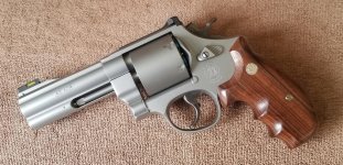

Be aware that a standard S&W 45ACP cylinder is 1.540" long.
The SAAMI max COAL" for a 45 Colt is 1.600".
Some bullets exceed that length when seated to the cannelure/crimp groove. Heavyweight bullets even more so.
A standard S&W 45 Colt cylinder is 1.670" long.
Now if there only was a cartridge that had a case longer than the 45ACP but shorter than a 45 Colt's, for heavy bullets, or one in between that wasn't designed for 40K psi pressures & one that took less work to convert to but you could still shoot 45ACP/45AR in it too?
Hmm... let me think? 🤔 :p
Blue Dot. I do like the idea of your 45 Short Mag. It would be the way to go for the reloader who wants more than acp from an acp cylinder. Just ream the cylinder to correct depth, shorten up some brass and have at it.
But, I prefer to be able to fire both colt and acp from the same cylinder.
I had a 25-3 which had the shorter cylinder. Same length as a non recessed N frame 357 and about .038 longer to the rear than an acp cylinder. I also reamed out a couple 357 cylinders. I did find a few bullets that were too long for those cylinders. My 255 gr SWC and the poly tip of the factory LEVERevolution rounds. Usually not a problem.
Later S&W starting with the 25-5 they went to the longer cylinder. As 45 colt cylinders with .452 throats were hard to find I started using 44 mag cylinders reamed to 45 colt.
I left my 325 with the short cylinder, I could have trimmed the barrel shank and fit a longer 45 colt cylinder cut for full moon clips, but I wanted to be able to return it to stock and I don't plan on firing any of my warmed up 255 gr loads in it.. I could also install a new style 45aco ratchet in the cylinder with the 45 colt length chambers and fire DOWNLOADED 45 win mags in it.
