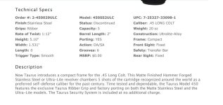

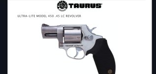

the Taurus 450 Ultra-lite is a lightweight 5 shot 45 Colt.. discontinued, and getting difficult to find, but a solid mighty pipsqueek if you can get one... have never tried "big" loads, but quite manageable with cowboy loads
