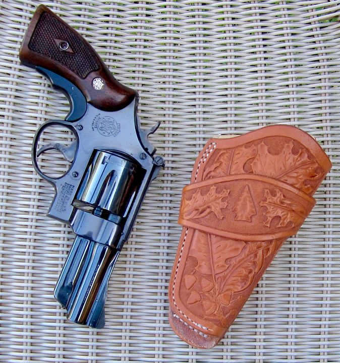

I've got an early 50's 3 1/2-inch N-Frame .357 that's less than perfect, but sure is a dandy way to do .357 Magnum as a side arm. It came with Magnas and the T-Grip is a nice addition for fit, not for looks. I think T-Grips look hideous, but pretty is as pretty does. I've toted it fairly regularly, especially since a friend made a nice Brill style holster for me.

The 3 1/2" M27 speaks of "lawman", or working gun.... While they can sub as a "target" gun, IMO that is not their correct and proper role...
Having said that I believe Target hammer and trigger on a 3 1/2" M27 is a waste, they need to have standard hammers and triggers as noted by many above.
Here's my two, properly equipped as noted:
