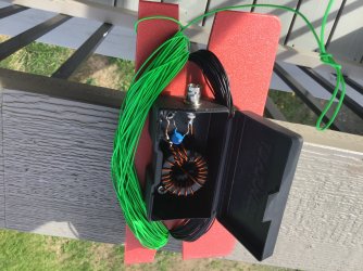

My mobile setup dipole antennas are made with cheap coax to banana plug adapters and 18 ga wire. Granted that's single band but I have pairs of wire tuned for different bands and can swap them out. I made 40,20 and 10m iirc but have 17m as well because I got rambunctious trimming to tune thinking I was taking too many short bits off I lopped off too much trying to hasten the task and went too far.
I also made an endfed, A black plastic box that Barnes TTSX bullets came in contains a wrapped toroid, a resister and a BNC coax socket. Same cheap 18 ga wire used for the antenna. It's bolted to a winder I made from a dollar store thin cutting board.

Thanks for the ideas. Im working on it
