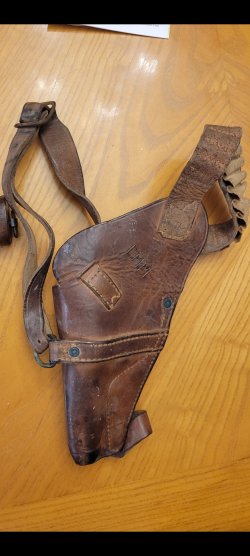

I recently picked up a Victory revolver and holster which have been severely neglected. The worst is it appears the revolver and holster sat somewhere where water leaked onto it, corroded through the holster, and then severely corroded part of the revolver's exterior. Otherwise, the holster's leather has been allowed to become fairly brittle. As a result, a section of strap which went through a buckle has almost ripped in half.
I'm looking for recommendations on what I can use to preserve the areas of the holster which haven't broken. I'm also interested if there's anything I can do to bond/seal the split leather strap pieces together. I don't expect it to be functional, but I'd like for it to look presentable in a display case. Screenshot_20250710_084205_Gallery.jpgScreenshot_20250710_084233_Gallery.jpgScreenshot_20250710_084859_Gallery.jpg
I'm sure others will be along with recommendations, but just wanted to make sure you don't use Neets Foot Oil on it. It may cause more damage. Look for a good leather moisture, like Block Rock. I'm sure there are many others probably better. Also, don't overlook a local shoe repair service for repair of the torn leather.

I would leave it as is for display. If you "preserve" portions of the undamaged leather, the holster condition will be uneven. Right now, the overall appearance of wear and condition of the holster matches.

I've heard that recommendation as well, @kwill1911 but my concern is, if nothing else, the torn portion of the strap is fairly close to being torn off. You or anyone else can correct me if I'm wrong, but the strap being torn off would harm the value more than taking steps to preserve it. Likewise, since the next level down for condition is it being torn in half, I doubt I can do much more harm to the material than that

As long as it is just for display, I think there is no need to restitch the strap. A "gentle" clean can be done but no saddle soap, no neatsfoot oil, no magic unguent that "feeds" or "reconditions" the leather. Twaddle.

I've also adjusted the strap so the segment which is being stretched and torn is no longer in the buckle, which I figured was causing it further strain.

I'll probably just brush the holster and focus on scrubbing the pistol for now while I weigh my options on doing anything further with the holster
Might want to look at TM9-850. The 1942 edition is available from g**gle books and probably also at the internet web archive. Pages 27-28 will provide a pretty good idea about what the Army thought was best at the time, and how your example was originally treated.
We have a pretty good shoe repair shop over in Fox Chapel. If it was mine I'd ask him for suggestions, as H Richard up above mentioned. Maybe you have a shoe guy that could offer suggestions. I've cleaned up a couple older holsters with Ballistol and a cotton tee shirt rag. But with that tear, I kinda like the "do nothing" mentioned above. Good luck. It's for display so that may be your best idea. If you do get it fixed up, you are obligated to show the results!!!

So it looks like the strap has already been repaired. I would have that professionally restitched.
There is nothing you can do to repair the broken area that won't dramatically affect the look of the entire holster and ruin it's vintage feel. The rig is pretty complete and is cool looking even with the damage. The only concern I would have is mold. Some leather conditioners darken the leather - which you don't want. I use Bick 4 leather conditioner and put on a few coats. It protects and smooths the appearance without darkening the leather.

That's also interesting @Gun Relics why do you believe it's already been repaired? I think I'd leave the hole in the body of the holster though, yes. Right now I'll definitely brush it, I'm leaning towards finding some substance to apply to the leather, and I'm leaning away from stitching the strap but I'm also concerned about it breaking entirely. Thinking about it, whether I stitch it now or after it completely breaks is probably about the same thing from a collecting standpoint
It looks like it was stitched at some point but it came apart. Could have been a field repair. Here's a blowup and lightening up of the photo. See the threads? If that's just a seam that came apart below the tear, you could have it stitched and hidden by the new seam. I have bought similar original WWII holsters in great shape for $150 - $200 so you may want to do that, but yours is a complete set. For .45's it's similar to an M3 "tanker" holster because the tank crews liked shoulder rigs. The Victory version had .38 belt loops and different stitching.
