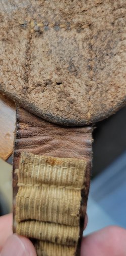

If it helps resolve it, here are some better photos of the damaged areas. The first is one section by the buckle, the second and third are the area which has already been shown, and the fourth and fifth are where the strap meets the holster since that feels weak. This is my first M3 holster though so I have nothing to compare it to.20250710_225332.jpg20250710_225308.jpg20250710_225243.jpg20250710_225539.jpg

Yes, they do look like fibers. The leather has just deteriorated and wouldn't hold a stitch anyway. Best to just leave it alone for a display.
if you dId want to fix it, the rotted area would have to be cut away then the pieces stitched together in a butt joint. A good leather worker could do this and it would not be obvious. It would not be as strong as an overlap joint but you aren't using it as a functional holster anyway.

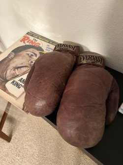

These gloves for my mancave were early 1900's, some of Everlast's earliest logo gloves stuffed with feathers. They were pretty ratty when they came in. I treated them for several days with Bick 4 a few years ago and they are still very soft and supple, while retaining the vintage look.

Gotcha though on the Bick 4, I must have missed that earlier. The gloves do look nice!

I recently picked up a Victory revolver and holster which have been severely neglected. The worst is it appears the revolver and holster sat somewhere where water leaked onto it, corroded through the holster, and then severely corroded part of the revolver's exterior. Otherwise, the holster's leather has been allowed to become fairly brittle. As a result, a section of strap which went through a buckle has almost ripped in half.
I'm looking for recommendations on what I can use to preserve the areas of the holster which haven't broken. I'm also interested if there's anything I can do to bond/seal the split leather strap pieces together. I don’t expect it to be functional, but I'd like for it to look presentable in a display case. View attachment 774681View attachment 774682View attachment 774683
