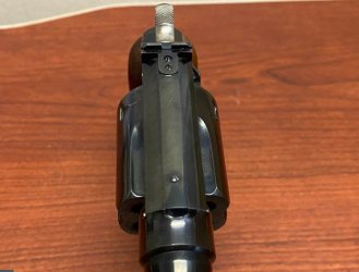

Can anyone point me to a quality screwdriver with the proper tip to perfectly fit the tiny K22 sight adjustment screws? I have tried several and they don’t fit well. An original Sight Adjustment Tool (SAT) would be awesome but I don’t have the money for that. I do have the money for a quality hollow ground and properly heat treated screwdriver. Does Grace make one or Wera or similar?

Reading this post and realized I have a pre-war Outdoorsman, a Brownells S&W specific screwdrivers and an 85 pc. Wheeler screwdriver set. Let's see what fits. Answer: Sorry, nothing I have on hand is even close, every bit is too large. The closest is the smallest bit in the wheeler set, bit no. 152-854. The thickness looks good but too wide. If you use this one you are going to have a nice ring of bare steel around the screw when you make the first turn.
I guess I now have the same question as the OP, what is the correct screwdriver for this tiny set of screws?
So far the options for me are grind down the Wheeler bit to fit or pony up for a pre-war SAT.

Thank you so much. You clarified this issue a lot. It’s nice to know the S&W specific bits from Brownells doesn’t work. Now if only someone made a reproduction SAT.
I am not so into grinding down a bit to fit. 152-854 might be the ticket if I have to do that though.

This is surprising! All I can tell you is that the smallest bit in my Brownells S&W set fits my K22, 18, and all my other square tang tiny leaf screws, which are all the same size. I don't have a pre-war, but my K22 was made in 1956/57 time frame.
The sights on a post war K22 have the micrometer adjustment sights from what I have been told and those use different screws.
