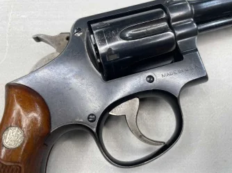

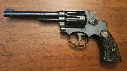

My LGS went to a strictly online model and I saw this Smith that has seen better days for 400$. It is being sold as a Pre-Model 10 model of 1905 it has the Made in USA roll Mark and the older style hammer of that period. I don't own any historical pieces and it's weird bc usually I prefer guns with pristine finishes but this one just speaks to me for some weird reason. Also seems to have text on top of the barrel which I've never seen. I was curious if anyone could ballpark a year or tell me more about this one.1000046209.webp1000046208.webp

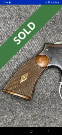

I figured the stocks were wrong based on some videos. It's a shame because the original stocks of that time are gorgeous. Even so, I may have to get this oldie but goodie. It's missing a lot of blueing on the barrel and is scratched to oblivion but I can't help but respect the fact it's still going strong 100 years on.
Those are patent dates for the various patented changes made to that model over the years. The last one on your revolver will be December 28, 1914.
Patent dates remained on S&W barrels until after WWII (approximately 1948). All of the S prefix M&P units I've looked at (many thousands) except those with the 2" barrel have the patent dates. Some early C prefix units (starting in March 1948) also had patent dates on the barrel. They ended the practice soon after that.
So overall for 400$ what's the verdict? I am thinking since I don't have any pre-war Smiths and it seems to be a shooter grade gun with character that I bag it up. Yes it's rough, but as a historian I feel like it's got a unique charm. This gun was not a safe queen and won't be for me, either if I decide to get it.
