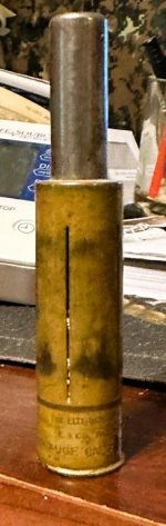

Found these in my collection There are 18 left in the box. Wonder if they would work, as they say not for fire arms.

An Echometer is a device for measuring fluid levels in oil wells. Works sort of like sonar. Those I have seen all used .45 Colt blanks. Maybe 10 gauge shells work better for measurements in deeper wells. I believe other depth measurement devices have now replaced the echometers that use blank cartridges. Well pumpers used them to adjust pump jack pumping rates. The oil pumping rate must be regulated so that the amount of oil being pumped out of the well over a time period is close to the amount of oil flowing into the wellbore from the formation to optimize production. So the oil level in the well should be maintained fairly constant. I had a new Echometer stolen out of my truck once.
Those shells would probably work for a salute cannon.
