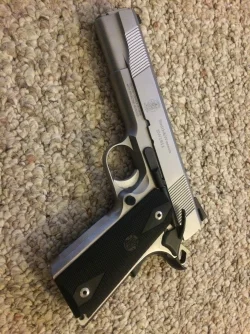

1006 10mm Label question
I have no idea and never seen that before!
I think the key to finding your answer lies in the 108281 product code. In the SCSW5, it is not listed. I cannot located my SCSW4 to see if maybe it is listed there.
I would guess that given the date on the Spec Ord, that seems like an early pistol to have the newer white followers. Maybe a previous owner updated the magazine followers. I would have expected the yellow followers.
Certainly an interesting find.
Yes, the white followers are misleading. Any early 1006 would have come with mags with yellow followers.
Ser.# TFJ 0028 puts production in 1989, if I'm not mistaken. Someone swapped those yellow followers out for the later, 'upgraded' white ones.
I'd want to know if the mags are stamped 'ES' on the front panel.
I was under the impression that the very first S&W 10xx pistols shipped in 1990. These guns started with a TEN serial prefix.
TEN would have been close to the letters they had been using at that time, I guess they thought TEN was cute. I think it was a silly idea, but I'm sure many disagree.
I don't think we had any S&W 10mm guns in 1989.
@Sevens check out this link below. … A 'TFJ' prefixed 1006 linked to 1989 production:
S&W didn't ship 10XX-series guns in order of serial # but just in terms of how many were needed to fill an order. 10 guns, 50 guns, … or 250 guns in the case of a department or agency order.
That's one reason the so-called 'FBI prefixes' for Bureau 1076s are inconsistent. There's no one prefix for all 1076 ordered by the Bureau since there were at least three batch shipments of 1076s from S&W to the FBI.
FWIW, my own 1006 is TET 19XX which makes it a 1990 gun.
Mine is a mid-January 1990 gun with a TFB prefix.
@Frank Black, my mags do have the "ES" stamping, can you enlighten me on the significance of this, pleaseView attachment 790154View attachment 790155?
Yes, it means the 'ES'-stamped mags are early 10XX-series mags and should have yellow followers. They are correct for an early 10XX gun in the series, ... 'early' meaning by serial # in the production sequence.
Later mags were stamped 'ES-1'. At that point, they came with white followers. Still later 10XX mags were stamped 'MS-1.' Those also came with white followers. There is likely some overlap in the transition from yellow to white followers.
Bought from MidwayUSA circa 2005-6, I have two NIB 'ES-1' stamped mags and one NIB 'MS-1' stamped mag. All have white followers. The plastic boxes they're in have never been opened.

I think it's accurate to say that 1006 production started in very late 1989 with most of the TEN- thru TFF- 1006s coming out in 1990.
The TFJ-prefix 1006s like the OP's, or some number of them, could've been a special order/run made for testing purposes ... hence the "field school" reference on the box? Just a guess.
The Spec Ord Code of 1035 would imply Feb 1991 - Also can track lots of TFH, TFJ, TFK prefix 3rd gen pistols running from mid 1990 to very late 1990. As to the 108281, there is at least one more 1006 TFJ sold "Used" with a 608281 product code
Yeah, I don't think we can get further than guessing. It's frustrating. It's especially frustrating in my opinion because it's not like we are searching for records from before the Great War. I was in frickin' high school and while I am no spring chicken, I'm still a youngin' on this forum. 😂
I'm certain there must exist some folks who remember so many of these details that most probably find mundane, but to some of us, this is very interesting history and it's going to be lost.
