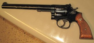

17-4 should I modify it?

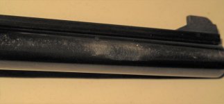

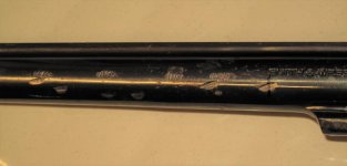

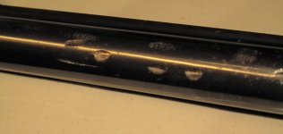

BTW, don't swap the barrel and cylinder, the parts will cost as much as what you would have to give boot if you traded it on a nice one.

As for the barrel? That sucker would get lopped off to 3 1/2" maybe 4".
I am biased as I don't care for a revolver sporting a barrel longer than 4".
