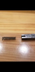

1932 38/44 rebound spring number of coils

Was probably cut to reduce DA pull...
Replace with a Wolf 13 or 14#.... Almost all my Smiths have 13s...12s will only work well with very polished and tuned actions...
An un-modified spring will have a closed coil at both ends. If it doesn't then the spring has been shortened, regardless of number of coils. Coil springs sometimes do weaken with use due to fatigue. If you are concerned then replace it with a new factory spring.

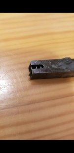

heres 2 pics...1 end seems clean...the other rough cut?
will take a pic tomorrow...
