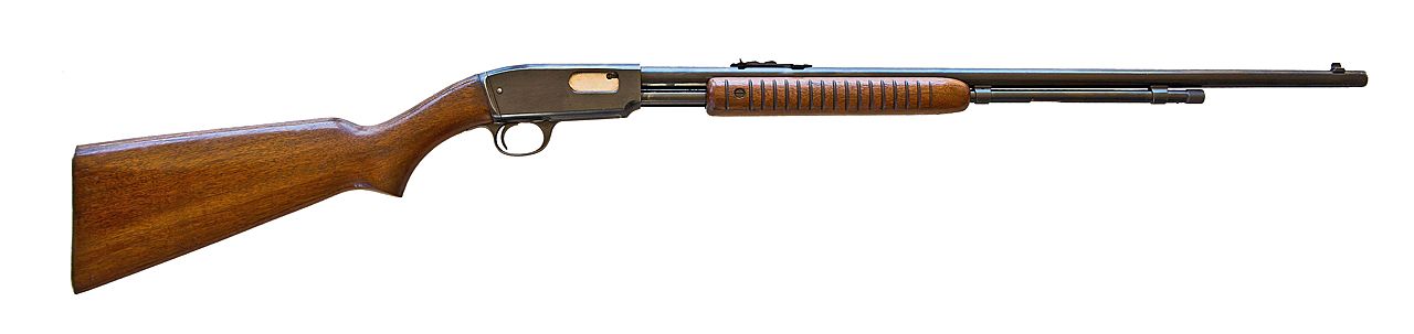

John,
You may already know this, but I'll take a chance anyway.
Winchester, like S&W, didn't throw away parts when design changes were made.
You're 62A is a "transition" gun in that it has the post war forearm but the pre war stock with the sharp comb.
Nice looking rifle.[/QUOTE
Thanks! I was aware that it had a combination of old/new features. It also has a mid-section horizontally-grooved steel butt plate - I believe this came from another model's butt plate bin.
John

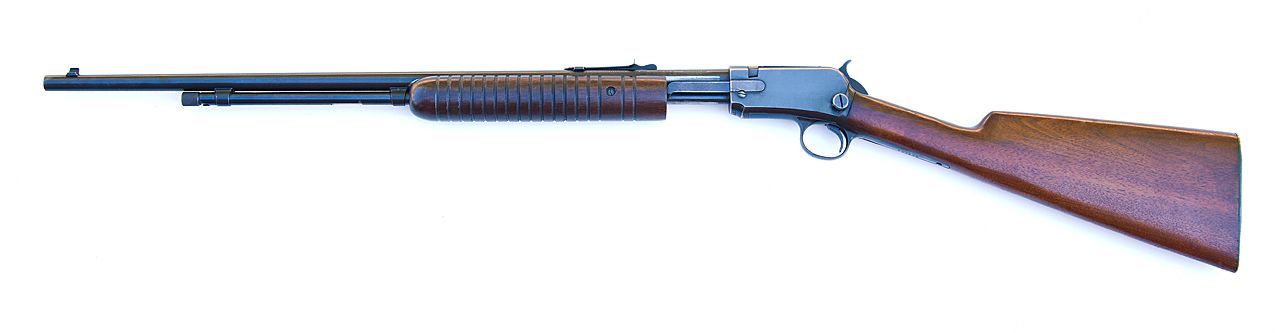

It's hard to say as the different internal hammer pump action galley rifles were generally similar.
The Winchester Model 1890 and 1906 with their external hammer and from the third model 1890 forward, large externally visible locking lugs were very iconic. That easy recognition was one of the big reasons why Winchester waited so long to introduce a sleeker, more stylish internal hammer design.
Savage had a magazine fed pump .22 as early as 1903, although both the 1903 and 1909 were magazine fed and not so suitable for gallery use. However the Model 29 had a tubular magazine and an inverted U shaped receiver just like the Remington Model 12 and it's subsequent Model 121 revision. The Winchester 61 also had an inverted U shaped receiver and a tubular magazine and all four of the designs look pretty similar.
Here is a Remington 121, in between an 1890 and a Model 62.
The Remington Model 12 and 121 were also commonly used as gallery rifles. What distinguishes them from a Model 61 is the slightly oblong shaped ejection port rather than the parallel sided oval on the 61, and the lack of any action bar.
On the Model 12 and 121, the entire magazine tube assembly cycles with the fore end, acting as the action bar. It's one of the elegant but complex pieces of engineering that John Pederson (of 1903 Springfield Pederson device fame) was known for, as opposed to the deceptively simple and elegant engineering John Browning was known for.
