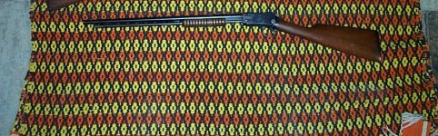

I acquired mine about a year and a half ago. It came from a friends estate. His grandfather was a shop owner in NJ in the '30s and it had always been in his family. Mine is a high number too, starts with 785XXX
