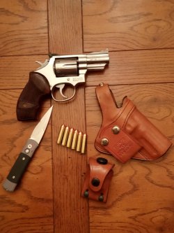

I've never had a 2 inch, but I've had three, 3s. So my opinion won't count for much, but:
This is silly, but I don't like the look of a 2. Anything can be over done, and a 2 inch revolver is one of those things. 3s are hard to shoot. It can. be done. It takes practice. But those 2s look impossible.
I also have a "fast" 3 inch Python that will shoot certain loads faster than my 6 inch 686. I can safely get a 158/1200 fps out of that Python. But then again, a 3 inch Python isn't exactly a small gun.
Again, just my opinion, but I think the SIG P365 has made those small revolvers obsolete. It's smaller, lighter, longer sight radius, better sights, good ballistics, easier to shoot well. And twice the payload. Probably cheaper, to boot.
