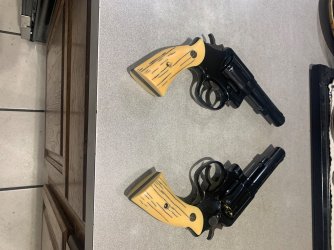

With all due respect, send it to S&W. They have a Lifetime Service Policy on all their handguns. They have totally refurbished 2 Model 10-8s for me. One didn’t even index. It came back working flawlessly. Call their number for the performance center, they’ll email you a label, box the gun up and take it to FedEx, completely legal shipping. They’ll send it to your house when they’re done. Complete overhaul including fresh hot blue was $220. They have a price list for their services.
