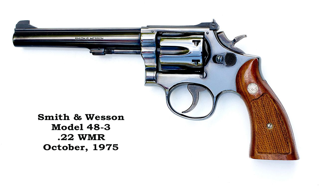

I looked at some old threads here on the forum, and somebody said they had put a model 48 cylinder into a 17 successfully.
Just to be clear, If I put a model 48 cylinder into a 17, are there any modifications that would need to be done or is it just a straight swap??
Aren't the 22 Mag rounds are about .004 wider?
I have not shot a 22 Mag and I may just get a model 48 at some point, but I did want to ask the authorities on here.
Thanks

It mostly depends on how much fitting will be needed to make the cylinder fit and function. It may drop in, but chances are a little fitting of some parts will be required to let everything work smoothly. It may also require more than "a little." These conversions have been done before, and even though the .22 L.R. bore dia. is a bit smaller, it seems to work very well. The hardest part of the whole operation is likely to be finding a model 48 cylinder. Might be easier to ream a .22 L.R. cylinder.
I don't know about width but they both should be 1.62" in length. I've got 48's galore these days and they are some of the most accurate rim fire Smiths I own. The two 8 3/8" guns both have the extra LR cylinders but I have not used them. Had too much fun with the 22 Mags.
When Ruger started the convertible Single Six's they opened up the bore to accommodate the 22 mag round and 22 LR suffered. don't know about the 48.
It will work. Might take a bit of fitting for the 2nd cylinder
