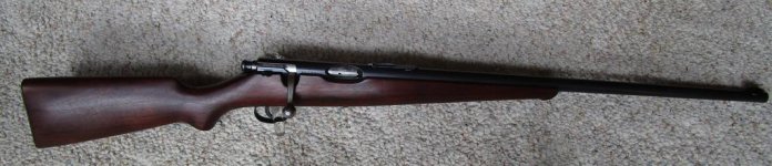

My interest in the 32-20 HEs has increased to the point where I'm on the hunt for a Savage model 23C to go with my revolvers.

The reason I am looking for the Savage 23C is it will also go with my 23A rimfire Sporter. One of the harder magazines to track down was for that little 22. Not ruling out the other 32-20 carbines mentioned above.
