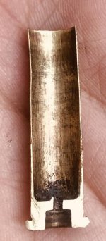

Maximum Pressure
I'm looking into the maximum safe pressure for the 32-20 rifle case and so far I'm not very impressed.
The original black powder load was 20 grains of FFG Black powder in the Winchester rifle chamber.
In order to use this case in the Revolving Rifle the case has to be reformed both at the case mouth and base. I don't see an issue using this low psi rifle case with the 32-44 Target after correctly reforming and cutting it down. Since the maximum load would be 11 grains of FFFG.
However, an increase to 17 grains of FFFG for the Revolving Rifle is concerning. I'm finding after close examination a very thing shell wall at the head of the case. After reforming the case it would be even thinner. Which makes things worse.
I'm going to see if I can locate some Super X High velocity shells and inspect them closely for case strength.
Standard cases in my researched opinion may not be able to safely handle a full load of FFFG powder in the Revolving Rifle. And that's not happening in my Revolving Rifle!!
If I can't find some Super X High Psi shells I'll likely just use 32-44 loads to be on the safe side.

Black Powder pressures do not require extra thick case walls at the base. 44 Henry was a single thickness rimfire case. and 45-70 originally had single thickness walls and rims and the internal primer could be set off through that thickness.
The 777 (Triple Seven) and Pyrodex powders are every bit as corrosive as black powder! They and lower velocity producing and much more difficult to ignite! If at all possible stick with Black Powder. Pyrodex CTG. is on the course side for a FFg powder. I would use Goex FFg (even FFFg) or Swiss 2 1/2 F powder, to get all the energy into your case volume. Use a Magnum primer if you can. I prefer CCI brand primers for small BP cartridges and Winchester for large cartridges.

Folded head cases
Ivan
Ivan,
I agree that the early folded head case did handle Large volume loads. However, the 32/20 rifle case being heavily modified from A bottleneck to straight case and then used or supported in a pistol chamber vs a very tight rifle chamber does impact case strength in a negative way and in my opinion is very questionable.
I don't feel like "testing" any theories out in my expensive Revolving Rifle. If it was any other cheap brown gun I wouldn't care. This one has to be done right the first time. I think the best bet is to start out with a 32-44 load and go from there. That's likely where I'm going.
