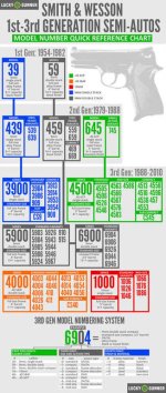

Chart for S&W Generation semis
Attached chart has been published many times but here is a copy you can print for yourself as you slide down this very slippery slope of S&W semis:D
You may think (as I did) that your first being a 39-2 is probably the only interest you'll ever have in semis by the famous revolver maker S&W.
Easy way to remember generation: 2 digit Model = 1st; 3 digit Model = 2nd, 4 digit Model number = 3rd.
