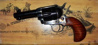

Circa 2000 Uberti Bisley 44S&W Special. Four click hammer.
My Uberti Revolver has four clicks.
1st click, sets about a ¼" off the frame,
2nd click allows the cylinder to turn for loading,
3rd click hammer is almost fully back but cylinder is not rotated into battery, l
4th click rotates the cylinder into battery and the gun will fire.
^^^ this is a good picture of the "safety" I was talking about in my post above that is present even on 4 click Uberti guns of fairly recent manufacture. When you put the gun on quarter cock, the little tab you see mounted on the hammer extends to block the hammer from falling even if the quarter cock notch breaks.
