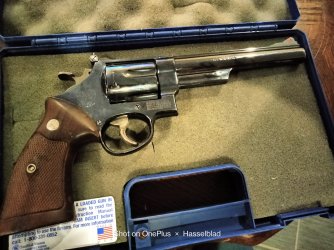

Greetings to all. Today I picked up a Smith & Wesson 44 Magnum 6-inch 4-screw pre-Model 29 with "Coke" grips.
The gun is about 95% with slight holster wear on the very end of the barrel.
The grips have a couple of chips in the wood, and the original owner scratched his initials into the bottom of both grip panels.
I would like to have these grips restored if at all possible.
Please let me know if you know or could recommend someone who restores Coke grips.
Please excuse the crappy pic. It's night time and my phone camera sucks.

Welcome back to the Forum! You found yourself a very nice 4-screw .44 Magnum with Cokes, and I believe a 6-1/2" bbl (measure from front of the cylinder to the muzzle). I have the same model (s/n S177963) that shipped in 1958, and it's probably my favorite revolver in my modest collection. Mine had an identical chip in the RH stock behind the trigger guard (very common, due to recoil), and I had it expertly repaired by DWFAN (now retired). I'm not sure if Curt (44magget) or one of our other talented Forum craftsmen is currently repairing stocks, but hopefully one of them will come along and help you out. Enjoy!
Here's a little different take on this set of cokes, My dad was a farmer, my mom was one of the better known country furniture antique dealers in the country and she taught me to look at things such as this set of cokes as history if we knew how those scars got put on that set of Cokes, the history is to me what is awesome about them, They're about beyond repair and you would destroy that history. I would be proud to own them actually and probably put them on one of my older 29's that I shoot and enjoy them, because somebody back in history that used to own them would be smiling.

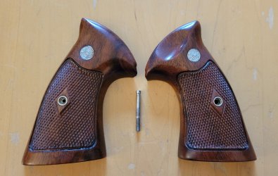

Coup, i finally heard back from James Mackey who I mentioned above. He can be reached at [email protected].20240307_094917.jpg Here is a pic of the cokes he repaired and refinished for me. Great job!
