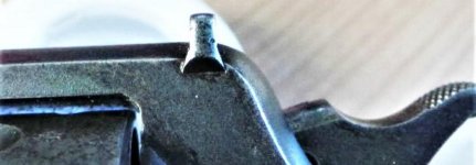

While I currently don't own the Revolver...I do have a few photos I've attached which should confirm the Drift-Adj. Rear Sights are identical!!
I also apologize the photos aren't as clear as I'd like them to be ,but this Revolver's Condition didn't survive the test of time as Your Revolver did...I did the best I could to edit them a bit for clarity so you could use them for comparison...Hope they'll be of some help!!

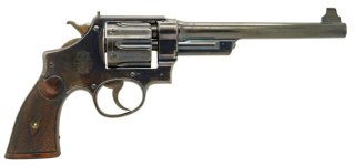

Sorry...Some sort of glitch with posting Multiple Photos so hopefully these will go through alright!!
  • S&W Triple-Lock Target .455 7.5-Inch Barrel Blue Finish with Factory Drift-Adjustable Rear Sight.jpg

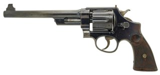

Still isn't posting multiple photos...Hmmm...Luckily only one left...Here it is!!
Thank you! 32 digits apart serial, identical configuration down to the unique rear sights, contract of 25 revolvers.. anything else than being in the same shipment would be surprising!
