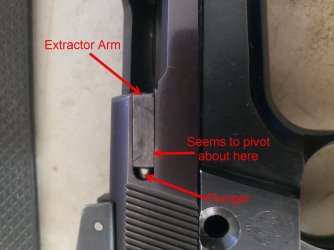

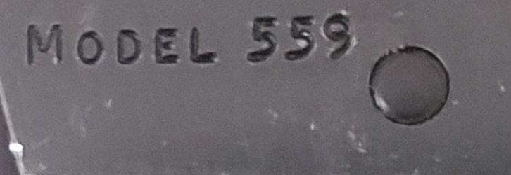

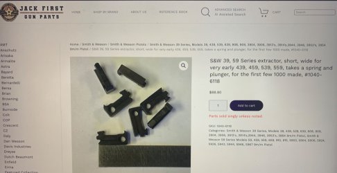

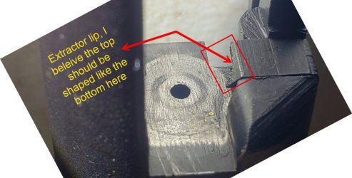

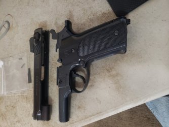

Hi folks, I am new here and I work on my own guns when ever possible. I have a 559 that has a broken extractor. I looked up the parts on Numrich and ordered from them and the extractor I received is definetly not the correct one. My fault, theres, I don't care just need to sort this out.
I'm attching some pictures for clarity and to show what I have. I looked at every series 59 drawing that was on thier site and after receiving the parts realized something is off. My extracotr is thicker and uses a plunger where as all the drawings I saw showed an extractor with a pin through it and side pushing spring. I'm open to any suggestions, schenmatics etc and or part numbers here.
A big thanks in advance.
MIke R

Numrichs shows the correct XM9 tool-less extractor in stock under the 459, for half of Jack First’s price. I believe the harder part to source for slides is the spring or plunger. Im sure they would swap it out if you give them an email
Thank you sir!!! Took me a while but with your info I finally found it on the NUmrich site and at $30.00 + thats great!. My plunger and spring are in good shape.
Mike R

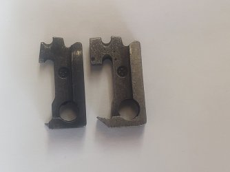

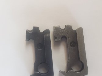

Good day everyone, I wanted to follow up on the end result of this repair. So I did ordeer the extractor pictured above from Numrich but it was not bny any means a direct fit. I understand many gun parts need fitting and this one needed a lot!!! I've attached pics of the old and new, I wanna say I have about three hours in filing on this part to get it just right. Many removals, filing, install, rinse and repeat. But it is relaibly extracting as it should now.
Once again thanks to all. Mike R

I try my best to make sure and follow up and or close out a post. As said all to often that doesn't happen.
Definitely a project, my calipers and files got a workout. I'm so happy to get this gun back in order. It's a great shooter, just a range gun. If parts weren't an issue I'd put a dot on it. Take care, Mike R
Good day, I wanted to post up my last comment on this as now I have had two range days with it about 200 rounds. The gun is running like new! It has had zero issues with feeding and or exrtracting so I'm convinced My work was good on it. In fact even though I said I woudn't due to parts availablity I'm reconsidering putting a red dot on it. If I do I'll make a sperate thread on the install.
Take care, Mike R
