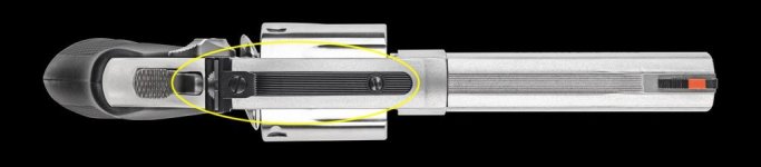

English is not my mother tongue so just to make sure, you guys are saying that it's easier to switch the whole unit (circled in yellow) vs the blade (in red)?

Yes, it is a lot easier to trade the whole assembly than the blade. For the assembly, there is just the one screw at the front. For the blade, there are multiple tiny parts and a spring, that are easily lost, and difficult to handle.
