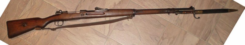

I need some help if anyone out there is reloading 8mm Mauser ammunition. We should be talking S&W, but I recently picked up a Gewehr Model 1898 Mauser, made in 1918 and found that it had the "S" stamp on the barrel, supposedly assuring me that it takes the larger .323 bullet. It has a .791 (.313") stamped on the receiver, which should be the bore. It is also known that the bore diameter of the Mauser was increased around 1905 to accept the .323 bullet.
I measured the grooves of the rifle at the muzzle and got .324. I then pushed a 32 S&W bullet through the bore and got a bore diameter of .315. That makes sense since the grooves were supposed to be .005, adding up to .325.
What I also believe as true is that the bullet should be the dimension of the grooves, while the bore is usually only the caliber identification and not the dimension of the bullet. I have read through several Forums and only get more confused because I think some people get bore and land dimensions confused when sizing bullets.
Many People on other Forums say that a .315 bore means the rifle takes a smaller bullet and shooting a .323 would be dangerous. Any thoughts would be welcome.

Thanks guys. Before I bought this rifle, I was sure of what it was and what it shot, then as I researched the gun, I started finding many posts on various gun forums stating that a .315 bore should not shoot standard "S" .323 bullets. Too bad so many people give bad advice and just plain inaccurate information. The good news is that I see only comments that support my original premise about the gun. I also have a sporterized 1942 K98 and reload quite a bit, so have the brass, the bullets, and the powder to get me out to the 2000 meter max setting on the rear sight. Now all I need is to find somewhere to shoot 2000 meters! This one is an all matching German made rifle sent to Turkey.

Nice rifle. As an accumulator of military rifles, I've been looking for a very good condition full length Gewehr Model 1898 for years.
