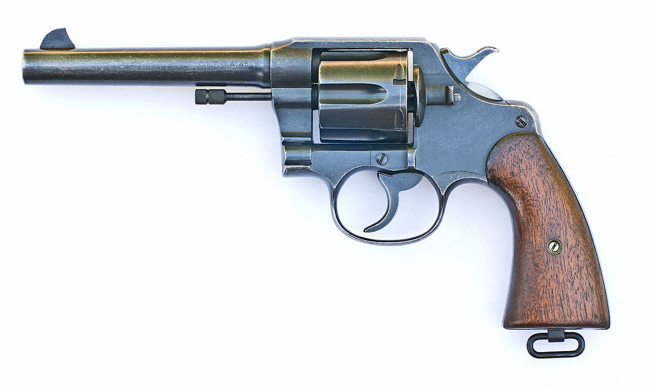

Early Colt 1917s from serials 1 to 30450 had bored-through chambers and had to be used with half-moon clips. I have one of these, illustrated here.

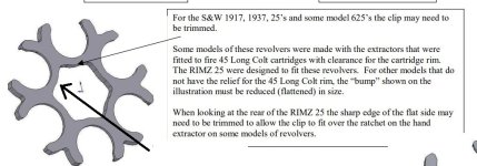

The RIMZ 25 is the one you will need for the early S&W M25 1955 Target Revolver. Mfr. states that the ones that fit the 625 will not work on the M25 as the ratchet hub is larger on the early 25's . I have a 25-2 and needed the RIMZ 25's to clear the ratchet hub.
You MUST file the inside of the clip to get it to fit !
Even the slightest radius on the inside of the clip hole will stop it from seating fully. FILE EM FLAT THERE.
They say you can use an emery board like your wife uses.
Well GOOD LUCK !
I used the cheap little diamond files from Harbor Freight. They are METAL so you can BEAR DOWN when filing. I would think an emery board would be too bendy.
Also..... I found holding the clips while filing was a real booger!
Solved it by filing the clips while loaded. (dummy rounds to be safe)
The LOADED clips are easier to hold and don't wiggle around.
I kept the gun on the table while working. Cylinder up so I could test each assembled clip by testing if it would go in the cylinder and the clip be flush with the back of the cylinder.
