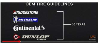

Although someone always disagrees with me, I know from people actually engaged in the making and selling of tires that the 5-year thing is a "sell by" date, not a "this is when your tires go bad" date. Your tires are still fine.
From here: [ame]https://www.youtube.com/watch?v=WwbLt8vZH5w&ab_channel=RevZilla[/ame]

Re the above utube vid. I couldn't find anything (to support his claim) on the Continental website. But Michelin puts this in their owner's manual: The “legal life of the tire” is six years from the date of purchase or the life of the “usable tread,”
"Legal life" makes me wonder if the DOT has issued some unilateral standard.
Dunlop: any tire that is more than six years old should be replaced regardless of wear.
As stated, I can't find anything about Continental's guidelines.
Bridgestone tires: Regardless of the tire’s condition or tread depth, it is recommended that tires more than 10 years old be taken out of service and replaced with new tires
Bridgestone's policy is the only one I can find that corresponds to the utuber's claim.
Edited to add: the utuber is connected to Revzilla, a popular motorcycle parts store. I used them often. He made this statement on a segment (that predates the utube vid): Avon is the closest with a recommendation of seven years, but Bridgestone, Michelin, Dunlop, Continental and others actually list 10 years as the allowable service life for a properly maintained set of tires, which I have to admit, was a shock.
The truth about tire age - RevZilla
Again, I can't substantiate his claim for any but Bridgestone.

OP here. I went ahead and ordered a new set of tires. Just ... because. Bridgestone Battlax Sport Touring T32.
BTW. On their website, Bridgestone says the usable life expectancy of their tires is 10 years. Ironic, huh?
