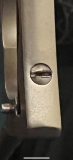

I need to replace my strain screw on my L frame, the head is bit damaged but still works . Does anyone here have a spare that they can ship to me to the UK ?

Can you put up a pic of the screw? I've often been able to carefully peen distorted metal on a screw head back into original shape or profile, especially the screw slot, even reestablish the slot with a fine hacksaw blade, then if necessary, chuck it in a drill and dress the head with a file or suitable (depending on amount of sheen desired) grit wet and dry paper. The head height will be slightly reduced, but still look good and be serviceable. Stainless, leave natural, blue steel, touch up with Oxpho blue after dressing and polishing.

here is a pic

Take that screw, dress it up a bit with a fine file. Then put some tape on the threads and chock it up in a drill/ drill press is best. Place some fine grit sandpaper(I use cloth like crocus paper/emery cloth) on a surface that has a bit of give to it , I use a 1/4 inch semi soft foam from some package. A thick piece of cardboard from a box will work, but soft rubber like materisl works best.
Push straight down with the drill and hold the paper from spinning. The give in the material will radius the edges of the screw nice and even if you hold the drill straight. If you want to polish it just use a cloth and polishing compound the same way. If you do this to guide rods, use a backing that is pretty firm, so they don't radius so much. They come out with a very nice swirl pattern. I have done it to most of my S/Ws that I carried. Especially 2nd/3rd gens that look like someone cut them with a hacksaw. Good luck

As long as the factory threads are not damaged;
95% of all screws can be reshaped or repaired, by a qualified machinist or Gun Smith.
When repaired, you need to acquire a screw driver that will properly fit the slot
and use care in placing the tip into the slot and keeping it there.
(Hollow Ground tip)
Good luck.

no, whilst i do have a wolfe reduced power springs inside i dont have any light strikes with it. I use federal primers. It just if you see from the photo i posted above, the head is abit buggered up so was looking to replace it but there is no real need to do so at this moment. The slightly longer 1/2 inch , 8-32 screw would be interesting to see if it will set up off harder primers such as cci and magtech as there is real shortage of federal primers
