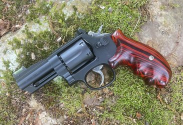

Black nitride is an extremely durable option that looks great, at least to my eye. It's not a paint or plating, it actually treats the metal, making it harder and extremely corrosion resistant. It's done by placing the parts in a 1100 degree salt bath for 30-60 minutes. I've done a couple Smiths. Turn around is usually less than a week.

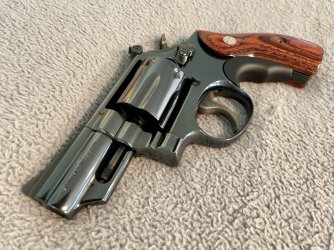

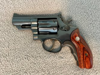

I sent my 15-3 in earlier this year. While it was still waiting its turn I learned here that they changed their process. Not sure how the standard polish and bluing would look I decided to upgrade to the high polish in hopes I would be happy.
I got it back last month and to me I can see that it is "blacker" than my 586 but with the high polish I am quite happy.
Yeah I wish it had the same look as the day I bought it NIB. But as awful as it looked after the police recovered it I'm glad she is nice and shiny again.
