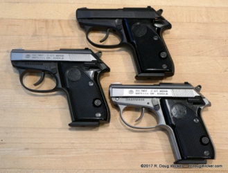

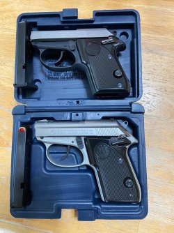

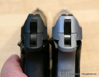

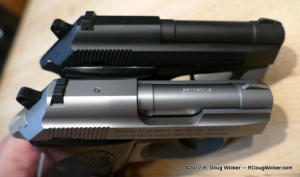

OK, here's the deal...
The "Tomcat" was redesigned by Beretta to address the known issue with hairline cracks develping in the frame's midsection. Interestingly, the fix wasn't to redisign the frame, but rather the slide. The redesign added mass to the slide to slow down the cycling speed enough that the recoil impulse wouldn't overstress the frame, which could result in the aformentioned frame cracking.
Since the "Inox" version of the Tomcat didn't debut until after this redisign, you won't find a stainless (Inox) gun with the original "thin slide" version.

Beretta has always recommended against using .32 Auto ammo over a certain energy level in the Tomcat, even after the redesigned pistol hit the market...
