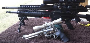

I use Jack Weigand's mount and rings (4) on my XVR. It has held up well.
You have to remove the rear site to mount it.
