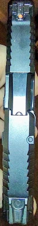

Before and after drifting BG2 sights.
Drifted both front and rear a tad to keep them as centered as possible.

I just picked up and shot my BG 2.0 today. Same thing. Shot way left @ 7yds. The rear looks centered and I didn't look closely at the front sight. I brought my Sig P238 with because I wanted to compare them both as pocket guns. The BG 2.0 wasn't even in the same ball park as my Sig. I'll drift the sight(s) and get some more rounds fired through it and reassess.
