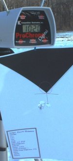

Well, I had the 405 grain 44 Mag bullet loads out to the range, and working up from the minimum charge this is the best group/load that was shot that day. I really didnt think that this heavy, long bullet would do this well in the Redhawk given that the twist is a bit shy for a bullet of this weight and lenght. But, being "open minded" I decided to pursue this excersize at the insistance of a friend. I shot at 20 yards (measured) which is perfect for my old eyes (cant hit what ya cant see). Most of the groups ranged from 1" to 2" depending on the charge weight, but as I came up with the charge I worked into this fine group. Velocity was 1020, and that is ballpark to where we need this bullet to perform. So, reloading and experimentation does have its surprises, and sometimes they are good! The maximum measurement of the group (I threw in the flier cause I am an honest guy), was about .750, and the cluster measured about .500, so, this would equate to one ragged hole at 25 yards, and well under 2" at 50 yards. The testing will continue as time permits with this load, but, I wanted to share this with you.

That's interesting, and I think you guys are on to something cool here. It can be hard to get guys to abandon their old beliefs about what is useful and what isn't, but when it comes to penetration with acceptable recoil levels, a 400 grain class bullet moving at 1,000 fps + is going to penetrate well, while not kicking you out from under your beanie. The Redhawk will take much stouter loads than these, but these should still work quite well in any decent M-29 in sound shape if someone chooses to use them. After all, they are a specialty item and not for every day shooting, but perfect for deep penetration on large game at close range.
Still, I bet you'll hear from the nay sayers.:rolleyes:
G4F; Our goal is to produce a bullet/load combination, that will as you say, penetrate well at close range, yet, allow for controllable double action followup shots....a last ditch dangerous game load for a backup revolver. Any revolver that is capable of throwing this 405 grain pill at 1000 fps should be able to get the job done, but, there is still much work to do. Now that I have an accurate load at the intended velocity, the next step will be a trajectory plot. This load needs to be able to produce a reasonable trajectory out to 50 yards or so. Comparing it to lighter heavy weights (300 and 325 grain bullets), this 405 load looks like it will be within sight adjustment for most revolvers, and if the trajectory remains reasonably flat in comparison, this load will show much promise. Keep in mind that in tests with this heavyweight, others in our group have found that with a muzzle velocity of 1000 fps, that the 405 is still traveling at well over 900 fps at 50 yards, so, we are hopeful that it will carry good velocity/trajectory beyond that, but our goal is close range self defense. I hope to accomplish the plot this coming weekend. If all works out, then the rapid fire double action controllability tests will come next, followed by penetration tests in media that replicates the structure and mass of large game animals. When all is said and done, we will make a final decision as to whether this bullet/load is up to the job, and meets the goals that our group has set, and if so, we will share the load data here so others with a need for this type of load will have access to the information............As far as "naysayers".........I would encourage anyone who can bring forth concrete physical evidence as to why this load would be unsuitable for the intended purpose to do so. Our small group has done this before, and with well over 200 years of combined experience we feel that we have covered all the bases....enough to make a verifyable decision as to whether this bullet and load will serve the purpose it was intended for.
