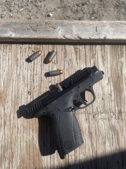

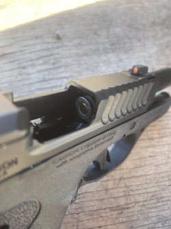

I just purchased a New Bodyguard 2.0 a week ago. Born on date was 03/19/2025. Shot it for the first time today. I am going to be 78 in 5 days. My right hand has had 2 surgeries and has arthritis. My thumb is fused at the middle joint. The reason I stated all this is that I have trouble shooting smaller guns, except this one.
I sold my Ruger LCP Max last month. The pain from shooting it was horrible. Bought the Bodyguard 2.0 as a hopeful replacement. All shooting at 7 yds. I 1st put 75 rounds of Speer Lawman RN ammo though it. Shot about 1 inch to the left of center. Next was 50 rounds of Academy Monarch ammo. Dead center. Then 50 rounds of some XTP hollow points. Again Dead Center. Finished with 20 rounds of Hornday Critical Defense. Slightly high Center. My hand was sore, but not bad. The slide locked back every time on an empty mag.
That was the good part.
Not so good. Had 4 jams. 2 FTF. Case was half way in . Had a bad angle. Both were with Lawman. 2 FTE Case was halfway out. Slide holding it in place. 1 with Lawman and 1 with XTP. The Lawman ammo was some of the dirtiest ammo I have ever used. Lots of blowback on the cases. None with any other. I don't know if this caused the problems or helped to cause them. Mag problems- Got 10 in the 10 round one, but can't lock it with the slide forward. Can only get 11 rounds in the 12 round mag. With 11, can't lock it in with the slide forward.
