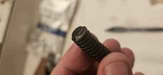

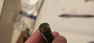

I think this is becoming a known issue
On mine it looks like the end of last coil on the muzzle end of the spring pops out past flange of the guide rod . This is not allowing the spring to compress when inserted into the slide.
If you push the end of the spring in and under the flange it goes right in. Works on mine anyway.
That being said you should not have to do this. I will be asking for a replacement.

I have the same experience with the spring end getting into the problem state.
Once the spring end is back in the proper position the installation into the slide is simple and easy.

I received my replacement today . Like yours mine is no different than the original . The end of the spring is already over the flange when it arrived . If anything it is more difficult to assemble. And yes once assembled it runs fine

Trying to attach photos of the guide rod spring showing the spring overriding the flange. First one it is over flange . Second pushed back behind flange .
Once this is done mine goes in the slide with almost no pressure.
I want to thank you for your information and your pictures. Once I was able to figure out how your pictures related to what I was seeing with my gun, I was able to see you were spot on. It went right into place and worked like a champ. Thanks again.
