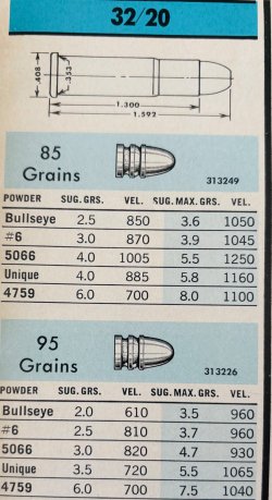

Now that we’ve confirmed a pistol platform you will have to hand load for your pistol. Rifle rounds won’t work well in your gun. Pistol loading data shown.
Also pistol bullets seen in photos. The rifle bullets don’t work as well either.
As far as lead? I’m sure you have sporting goods stores close with fishing supplies? You can always buy lead fishing weights and mold your own bullets. The cheapest bullet molds are made by LEE and you can mail order them. Pick one of the 3 types that are seen in the photo and you can’t go wrong. The best one by far is the SWC.
