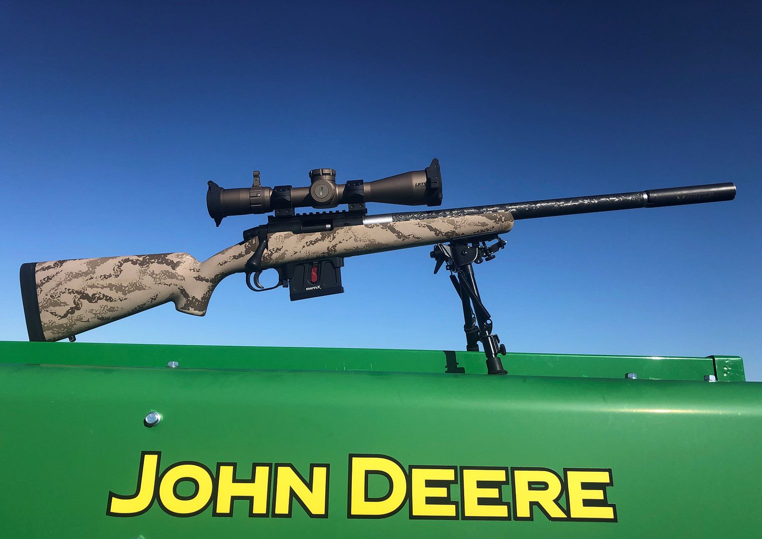

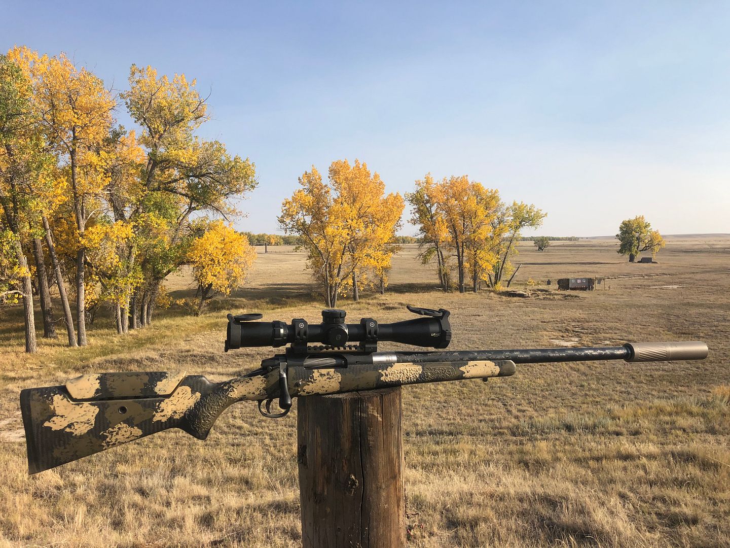

I have two rifles and one pistol with a CF barrel. Basically it's a light weight metal barrel with a carbon fiber sleeve around it. The sieve is basically woven carbon. My understanding, and I might be wrong, is it helps didipatr heat. There may be some advantage to allowing the barrel to oscillate at its natural harmonic frequency more easily but that's just my speculation. The weight out front is substantially less as well and accuracy on all three is excellent. All three of my guns are substantially lighter than ones with full steel barrels.
I'll try to remember to snap a quick photo and post it later.

First target is at 100 yds using a bipod on a Ruger precision 22 wmr and Hornady V Max ammo. Second a Thompson Center copy of a Ruger 10/22 off a bipod at 50 yards and federal bulk 22LR.

There is an article in the current Guns magazine on a gun with a CF wrapped barrel. One take home message from it is the barrel retains heat and accuracy suffers with many rounds shot quickly. I don't have one so no idea of the veracity of this statement.
Read the same in a Rifleman piece. Makes the rifle light for carry in the mountains, but you probably wouldn't want a carbon wrapped barrel for a prairie dog hunt.
The principal purpose of a CF-wrapped steel barrel is greater rigidity and improved barrel harmonics. That presumably results in tighter groups and greater group size consistency. CF is much more of a heat insulator than a heat conductor. If tighter and more consistent groups are what you think you need, a CF-wrapped steel barrel may be the answer if you have the $$$. To me, the CF barrel idea is absurd and preposterous as plain old steel barrels are more than suitable for my needs. And far less expensive.
Simple answer - Its a fad! Somewhat more detailed answer - lighter weight for those that desire to spend money on their hobby for a hunting rifle.
Proof started the fad years ago and they are great for hunting rifles because of the reduced weight. Do they enhance accuracy? not in my opinion, way to many other variables in rifle accuracy to pay the price for a carbon fiber barrel. they make a regular barrel, then turn down parts of the barrel and add the carbon fiber, for those that are financially challenged in reading between the lines, carbon fiber barrels are way more expensive that non carbon fiber barrels.
I do have one, I enjoy my rifles and have several total custom guns that I built over the years. My 6 creedmoor gun has a proof carbon barrel and yes, it is very accurate, it is my go to gun shooting steel at 1000 yards. I will never spend the money to buy another one and when this one is shot out, I may put a proof barrel back on the gun, but it will not be carbon fiber.
Nothing different here than we handgunners having to have a set of Kieth Brown grips on our favorite 29 or a golfer having to have a 2K driver in his group of clubs. We spend our money on crazy items in any hobby as guys.
If someone wants to debate the accuracy aspect, fire away, I have been shooting bench rest for 40 years and playing with accurate rifles for 50+. I enjoy my S&W revolvers, but I do not shoot them a great deal. I have burned many a pound of powder in the past 40 years shooting rifles at paper and measuring groups. Spending money on a carbon fiber barrel with the goal being "it will shoot smaller groups" puts one in the group P T Barnum spoke about being born all the time. Current state of the arts rifle work, you can build a rifle that weighs less that 5 pounds that will do hunting accuracy ( 3 round groups) as good or better than any carbon fiber barreled rifle one can build and with less money. Save your money and buy another revolver for the collection.
You can get a good quality barrel in a very slim configuration (#1 sporter) that will shoot at least as well as a carbon fiber barrel. Ask the owners of Ultra Light Arms rifles and perhaps the owners of other custom rifles with conventional barrels.
Sort of like the 5R barrel fad of a few years ago. Certainly good barrels but there are conventional barrels that will do just as well.

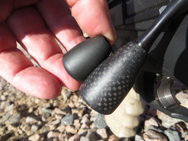

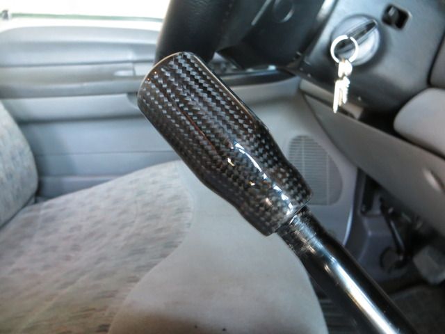

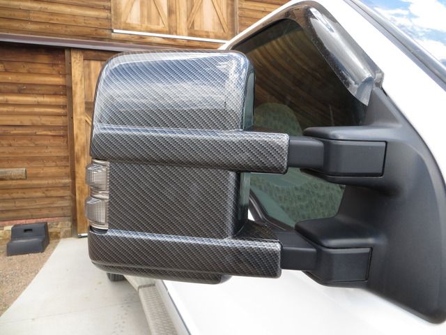

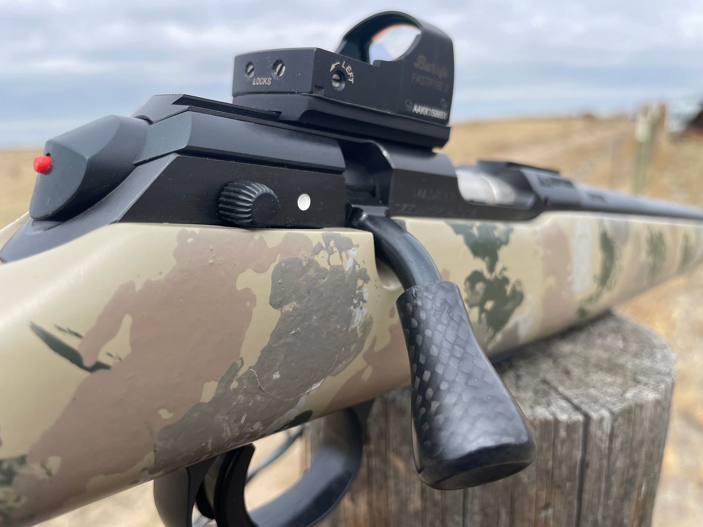

I love all things carbon fiber, I'd wear carbon fiber underwear if it were available.

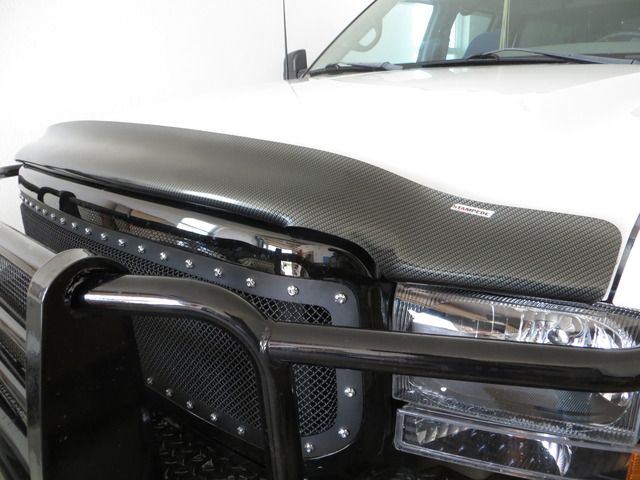

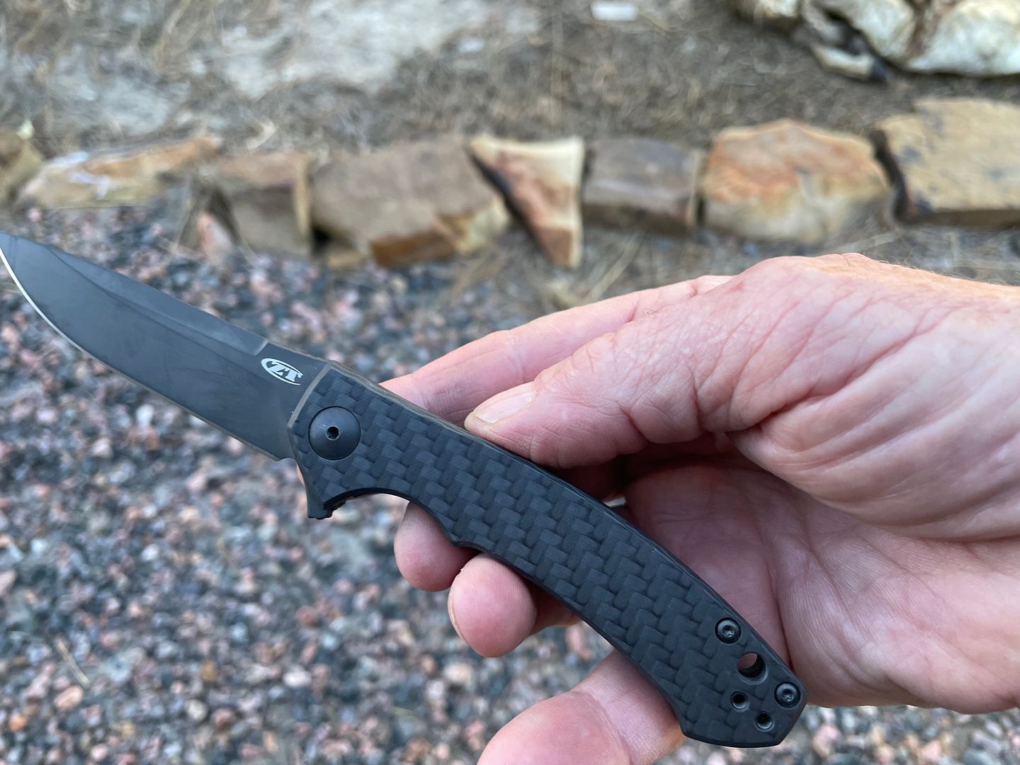

Uhh, I wouldn't go so far as the underoo's... But, bolt knobs, barrels, knife scales, gearshifts and auto accessories, yeah....

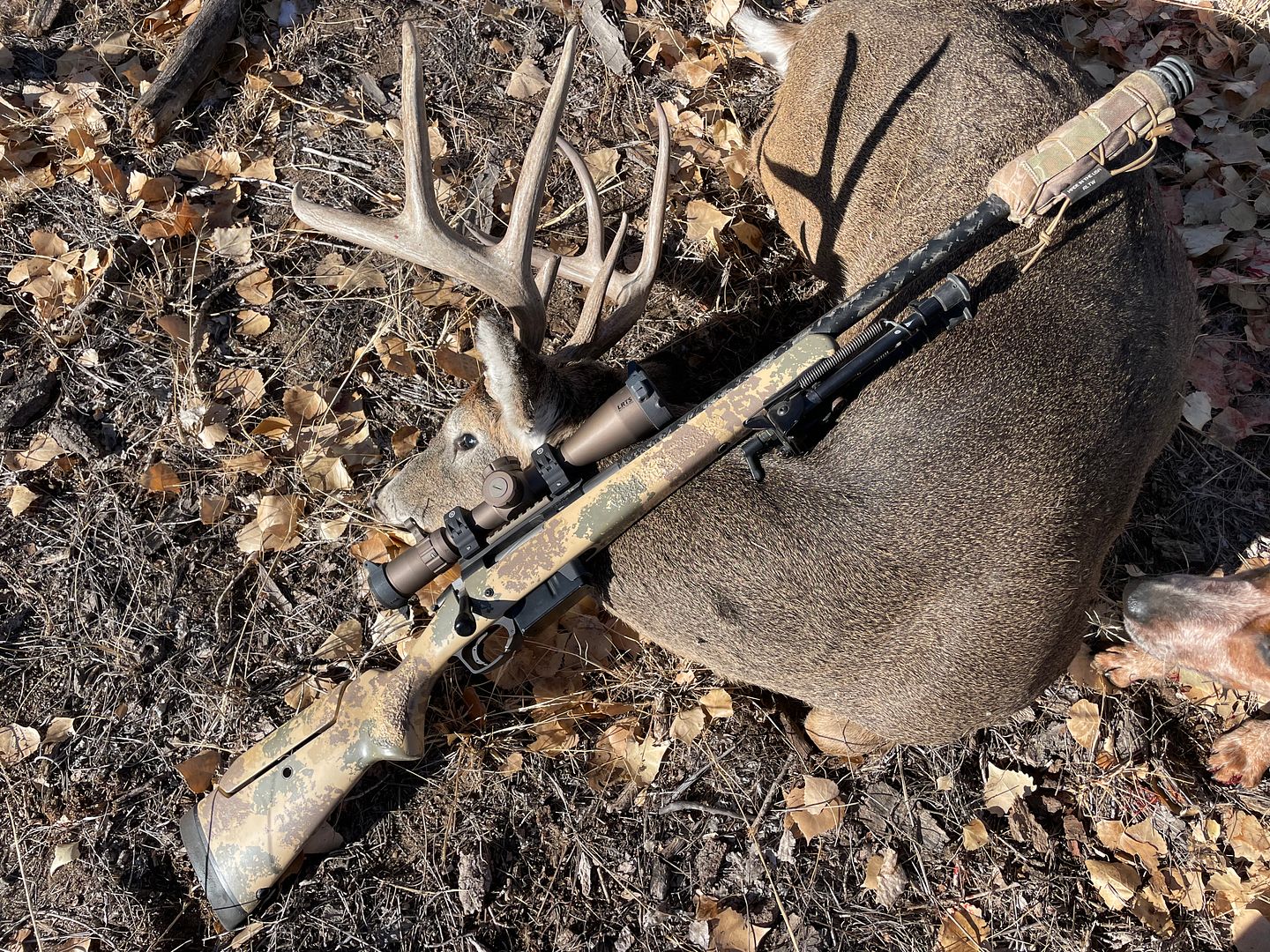

If you area hunter and lug a rifle around, then carbon fiber might help lighten the load a bit as it weighs less than steel. Hunters typically only take a few shots per hunt, so heat would really not be an issue on a hunting rifle.
